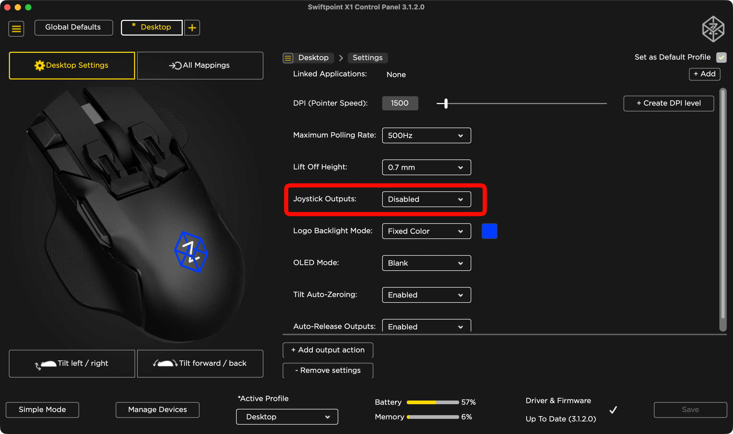

Hello,
I'm not sure if this is the right place, but I'm hitting a very annoying problem with my Swiftpoint Z3. It's essentially this problem, but I'm using a Z3 and I'm on macOS.
My info:
  1. macOS Tahoe 26.6
  2. Mouse connected via Swiftlink
  3. Mouse firmware: 3.1.2.0
  4. Joystick being interfered with: a Nintendo Switch Pro controller connected via USB
    1. The analog ↑ input simply doesn't work
My settings showing that Joystick Outputs are disabled.
Even though the Joystick Outputs setting is disabled, this problem recurs occasionally. I have to unplug the Swiftlink receiver, plug it back in, turn Joystick Outputs off, save the settings, turn Joystick Outputs back on, then save again.
